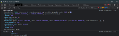

                    console.log("identifyParams", identifyParams);
                    identifyTask.execute(identifyParams, function (idResults) {
                        console.log("test", idResults);
idResults returns an empty array and I am unsure as to why.

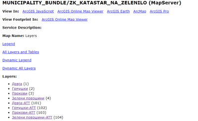

Are the layerIds you're setting correct? Can you share the URL you're using to verify the process?
by Anonymous User
Not applicable
@KenBuja
Here are the layers
KenBuja
MVP Esteemed Contributor
Then you'll want to modify this line since there is no layer 0. Your IdentifyTask would only include what is found is Layer 2. Include the layer ids you want to identify.
identifyParams.layerIds = [0, 2];

identifyParams.layerIds = [1];
identifyParams.layerIds = [1, 2];
I have made both of these modifications. For a fact, I know that the layer 1 has records in it and it still returns an empty array.

RobertMEIER
try changing you layerOption value, the documentation says it should be a string, either "top", "visible" or "all".
