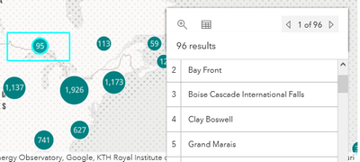

I want to show all features which are in current cluster in list inside the popup in 3.4, i want same popup of list as we get in arcgis api 4.24.
I have used hitTest() it is not working,
problem is i cannot get the features which are in the cluster on which I click(current cluster).

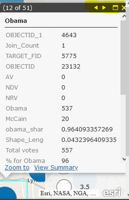

ZeeshanRabbani
Hi thankyou but this blog show same example as api sample shows
The yellow highlighted next and previous button i dont need this I need to show all at a time in a list.
LIKE THIS
Problem Im having is i cant get the items or features which are in current cluster(on which i click)
