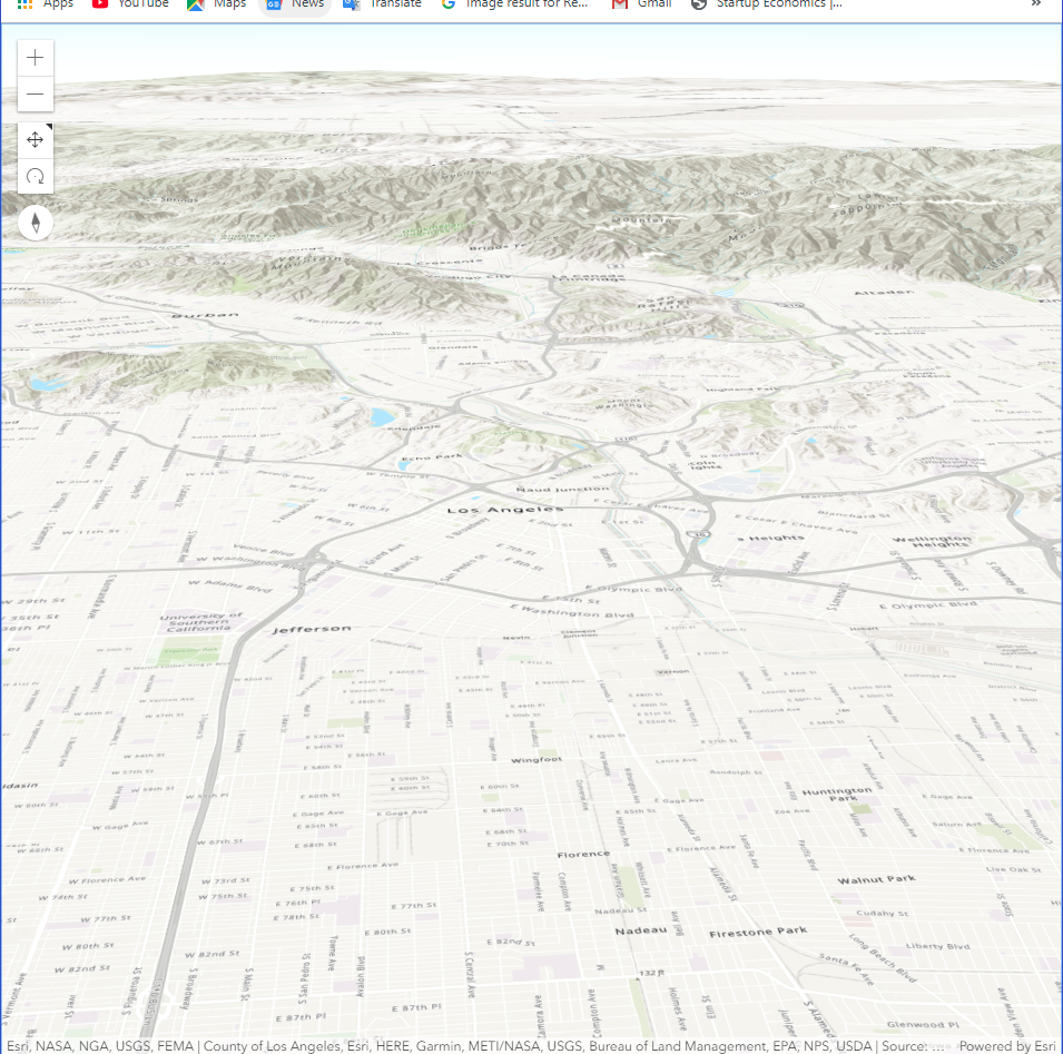

But this is what my webpage looks like
Seems like there is no point!! I looked around for it too in case the lat-long got messed up.
Any help would be greatly appreciated!
Thanks

Remember, case counts in Javascript!
You're using an uppercase Y when constructing the point. It has to be
var point = {
  type: "point", //autocasts as new Point()
  x: -118.255113,
  y: 34.042281,
  z: 1010
Get in the habit of looking at the console. It was reporting
[esri.views.3d.layers.graphics.Graphics3DSymbolLayer] point coordinate is not a valid number, graphic skipped

benjaminfriedman
Ahh!! Thanks so much Ken. I really appreciate it. It worked haha.
