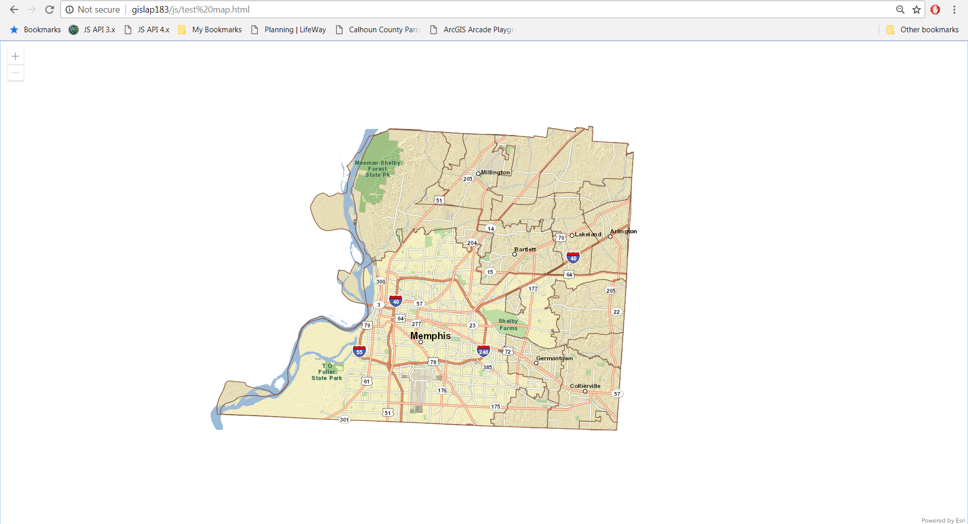

   You are not trying to run your code from the file system are you (file://)? If so that is the problem. As you can see in the attached image I am not having any issue with the code I posted:

Like I mentioned earlier that is the issue then. The 4.x api is NOT meant to run from the file system like that.

RobertScheitlin__GISP
MVP Emeritus
Correct localhost is considered a secure context in the JS API and will route traffic through https protocol.
See this thread for Rene's discussion on this:
https://community.esri.com/thread/217842-problem-with-httphttps
You need to use your machines name in the url. I already showed you my screenshot where I have it working and that is because I Never use the file system or local host urls.
