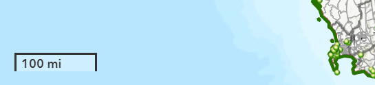

I am using a scalebar in my map to show zoom in/out level. Currently it is showing mi which I presume it stands for miles and ft which I presume it stands for feet. I am based in South Africa and I need to use the metric system how do I do that?
ScaleBar code:
var scaleBar = new ScaleBar({
view: view
// Add widget to the bottom left corner of the view
view.ui.add(scaleBar, {
position: "bottom-left"
This how it currently show

Hello,
Take a look at the API reference for ScaleBar https://developers.arcgis.com/javascript/latest/api-reference/esri-widgets-ScaleBar.html#style There appears to be a unit value where a metric display can be specified.
Thus your sample code becomes
view: view,
unit: "metric"
I cannot get access to the Javascript sandbox this morning to test. https://developers.arcgis.com/javascript/3/sandbox/sandbox.html?sample=map_simple so hopefully I have the syntax correct.
