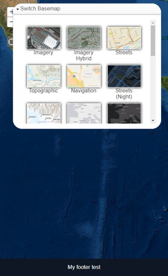

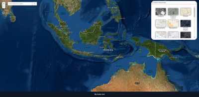

EndiHariadi
I use bootstrap elements like this:
    <footer class="text-center text-lg-center">
        <div class="text-center p-3" style="background-color: rgba(15, 23, 36, 1);" data-dojo-type="dijit.layout.ContentPane" data-dojo-props="region:'bottom'">
            <a class="text-white" style="z-index:50;"><span>My footer test</span></a>
        </div>
    </footer>
For me personally, this is enough.
