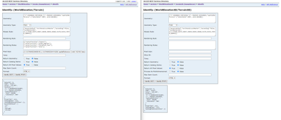

For some reason, the serviced you used (left example) is returning better elevation than the supposed one (right example) :
What do you think it can be? Also, I was wondering if I can request several altitude for several points...
Thanks for your help!
JamesIng
@LuisSolaRuiz  Unfortunately I can't say with any real reason why one is returning better elevation, likely missing the pixelSize parameter which is used to figure out the size of the area for calculating the elevation.

I've been doing some test with this functionality and it is perfect to know exactly the altitude of a point in the Elevation Layer of my scene view. It really matches the layer and when I used it, the point is above the ground.
So, this can be considered a solution, anyway, I still don't understand why when I query to the service that it's the same layer that I have in my scene view is returning different values 😞  It would be good to have both options because I will not have always a map loaded in the app to query it.
