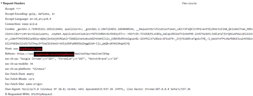

This is the request header for one of the map services trying to be reached:

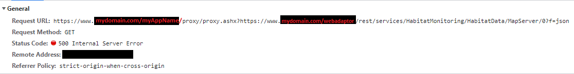

This is the error info:
The proxyLog.txt file gives me this error. I'm don't really know anything about networks, but I don't understand why it says I have a null referer yet the request header has a value in referer??:
The Proxy is being called by a null referer. Access denied.

Hi @MKF62 ,
Does the Referer in your request header https://www.mydomain.com/myAppName/HabitatMap/HabitatJSMap match the one specified in your proxy configuration?  It's possible that when you changed webservers the Referer (web address for your application) changed and would need to be updated in your proxy configuration. Do you have an IT department you can reach out to?  When it comes to network issues every organizations infrastructure is configured differently and these things can be really hard to troubleshoot without being on site.
