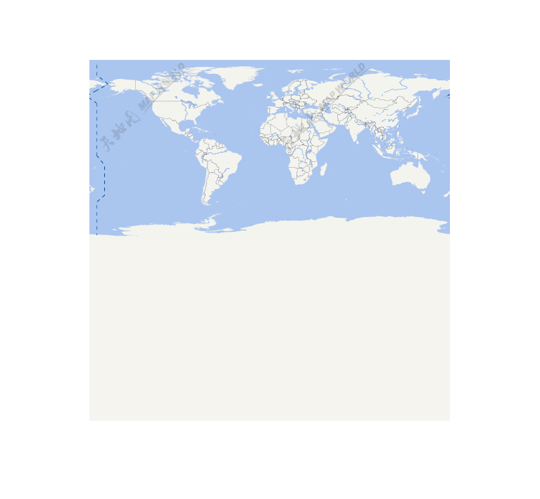

  • Using BaseTileLayer to create the customized TileLayer
      Using this method the map could be loaded but the latitude is shifting a lot from its real value, and the map looks like below:
It seems that the map is moving towards north a lot.
Could anyone please help me with this problem? Thanks a lot.
