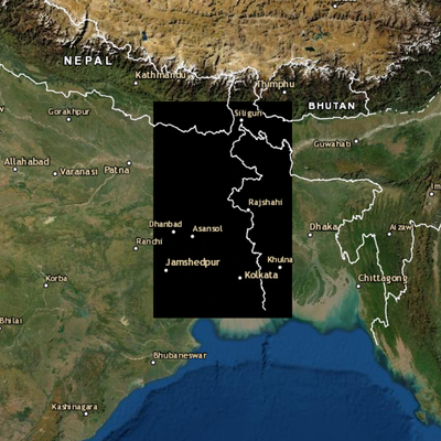

MariamJamilah
Hello,
Yes,  I will be using a UI to pick the years. The image service has a limited number of rasters and therefore I can pick the objectId for each corresponding year.
The major issue that I am facing is with displaying the output of the raster function. I am still unsure if using a renderingRule is the way to go about it. I have used the snippet that you have provided and I get a black image as output. I have attached the image and code (zipped file) for your reference.
As suggested, if I have to chain the raster functions as follows: arithmetic --> remap --> colormap. How do I use output of previous raster function in the following function and how do I finally display the result image?
Thank you so much for helping me out!

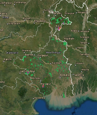

MariamJamilah
Hello,
I have updated the code and attached the recent zipped file.
I am now able to chain the raster functions and display the image (attached below), though not entirely sure if the output is correct.
I would like to know if there is a way to display (render) the positive and negative change (that is, display the increase/decrease post the Minus arithmetic operation). Would using a custom raster function be a good idea? Is it possible to do so?
Thanks!
JohnGrayson
Esri Alum
Glad to hear you got it working.  There are many ways to model and display the 'difference' between two rasters; two common types I use are relative and absolute.  Displaying relative values show how much gain or loss is associated with each pixel. Displaying absolute difference will translate the results into three values: gain, loss, and no change. Depending on the source data and desired results you might want to add a Remap RF that narrows down the results into a well known set of values, then you could more easily match these values via a ColorMap RF.  I hope this helps.
