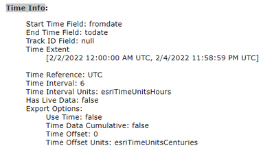

pragati224
I have updated the layer.and added it in 2d viewr but unable to add it in 3D. can you guide me how to add time slider on 3d.
https://services8.arcgis.com/Dxp0iiM83fijnVoI/ArcGIS/rest/services/Tree_D/FeatureServer/0

UndralBatsukh
There is no difference between 2D and 3D TimeSlider. The same settings for the timeslider will work in 3D. I tried your service with timeSlider in 3D and the time slider is set up correctly. However, I could not figure out the time interval for your service.
