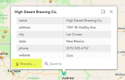

You can add an action to the popup that will appear in the footer. Your action could open a new browser window with your link.
See this sample, although it's currently broken. You have to make one change in the sandbox version. Change line 47 to this
url: "https://services.arcgis.com/V6ZHFr6zdgNZuVG0/arcgis/rest/services/OpenBeerDB/FeatureServer/0",
and click on a brewery with a website (not all of them have one). The popup contains a new icon that, when clicked, opens the link.
