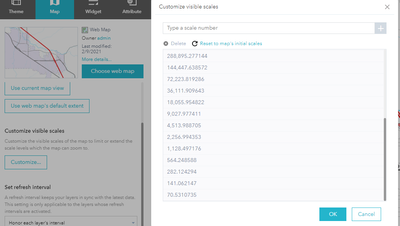

Hi all,
I'm creating a map application using the ArcGIS API for JS v4.18. I'm running into an issue where I can't add custom visible scales as in the Web AppBuilder.
It goes now to maxZoom 22 and I would add 3 more scales so I can go to maxZoom 25, as I have done in the Web AppBuilder. I tried increasing the maxZoom, but it didn't work out. I'm using the OSM basemap by Esri.
Is there a way to set custom scales/zoomlevels? And if so, how could I do that?
Thanks for any help!

VeliAlkan
Yes. However, this is in the web AppBuilder where i can add more scales. So i was wondering how i could do the same with the JS 4x API.
