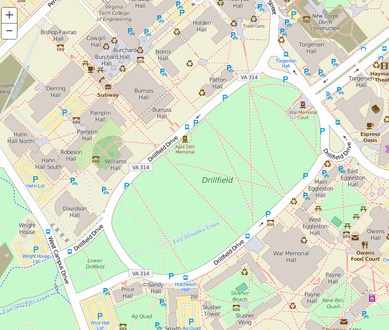

So I am in the process of making a map that has interactive capabilities and operates through a website. Right now I have the website, and the esri base map (open streets) is all that is on there. The website is essentially just the map. I am using the arcGIS javascript to upload the map and the coordinates and extents etc. A screen-shot is shown below.

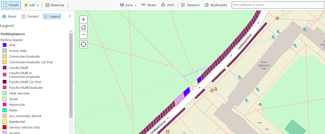

I need help with adding my layer to the map. The layer is compatible with arcGIS and esri, and I can add it the map editor, as you can see here... The rest endpoint data was obtained through a link.
->How do I add this layer to my web map?
