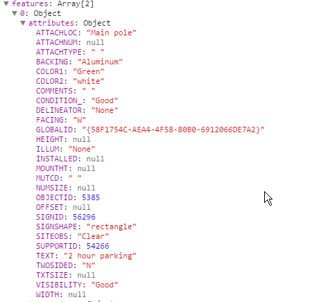

I want to obtain the attribute information of the following:
With the following code I can get the GLOBALID, but I am in need of each attribute. I commented out what I tried to add. It did not work. For now, if you can give me an idea on how to do a second one, I can do the rest. Here is my code:

RobertScheitlin__GISP
MVP Emeritus
Chris,
  You are setting the featureAttributes to one field (GLOBALID) and then you are trying to loop through that object...
Try this instead:
                    var featureAttributes = results.features[ii].attributes;
                    for (var attr in featureAttributes) {
                        console.log(attr + ": " + featureAttributes[attr]);

ChrisSergent
Deactivated User
I am not sure I follow. When you have an element on the for that is GLOBALID and ATTACHLOC, how does the code know how to put which attribute where. They don't line up in the same order as on my form.
MVP Emeritus
Chris,
   Do you not have a form element (an input or select) in your code for each of these attributes that has an id of the attribute name?
It does not matter what order the loop hits which attribute as
document.getElementById(attr).value = featureAttributes[attr];
will but the correct value in the correct element based on the attributes name.
