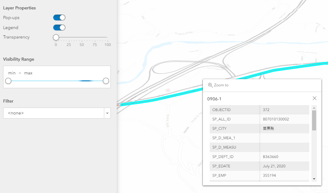

I created a Web Scene portal item and add a feature layer. I also enable the layer's popups property as below picture.
The popup is not working in below javascript API code. How can I do for let the popup working as protal server Webscene view?

I'm having the same problem. Is it possible for a WebScene based on a portalItem to show popups? They're definitely enabled on the feature layers, and I can get them to pop up when I open the WebScene in Scene Viewer online.
