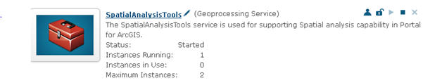

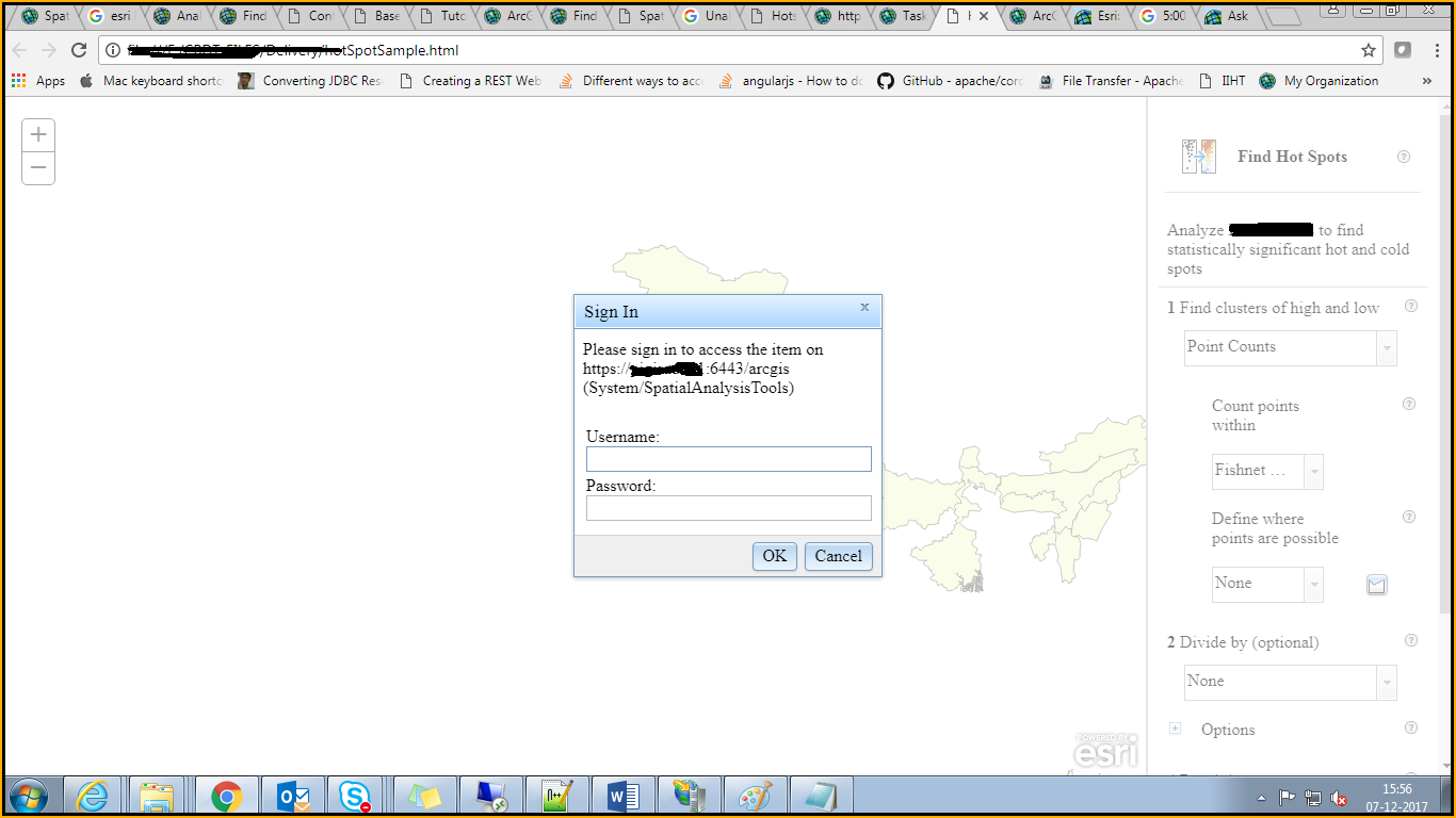

Though the service is not secured (i.e. available for Everyone"), It is asking for credentials every time.Please find below image for the same.
Credentials
After entering the credentials, Its gives an error "TypeError: Cannot Read Property of 'self' of null" in browser console. Screenshot has been attached for the same.
Let me know what is the possible solution to overcome this one.

Sorry I don't have a solution to prevent login beside using a proxy with credentials stored like Panagiotis recommends.
PanagiotisPapadopoulos
try to use the service using the web adaptor path (not through 6443 port).
This may solve the error not the Sing In Pop Up.

I am try to reproduce this behavior and behaves the same on me.
An alternative is to use a proxy page instead of share to everyone the service.
This solution will helps you stop arise the Sing In Pop Up
