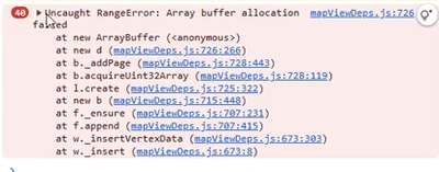

Hi,
Found an issue with FeatureLayerView.highlight in version 4.30.
When you use highlighting on a polygon feature layer, CPU spikes to about 15% (depending on how powerful your machine is) and it will stay that way forever even when no map interaction is happening. In addition to that, GPU activity is also high.

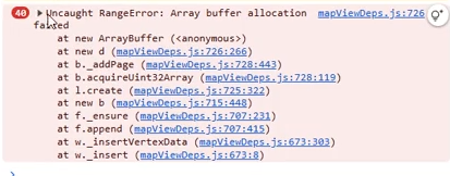

We also noticed that if browser session is left open for about 10 mins (again might depend on how powerful your machine is) and then refresh the page, you will get Array buffer allocation error from mapViewDeps.js file. This is how we found this issue originally.
We originally identified this issue in 4.30 but it seems to start happening in 4.29. It is present in 4.30, 4.31 and also in version 4.32 (next).
Find a sample here: https://codepen.io/jandic/pen/emOyBJK
Thanks for any insights,
Pavel
UndralBatsukh
Hi there,
We addressed this issue in our upcoming release (version 4.32). You test the fix in next (4.32) version. Here your codepen updated: https://codepen.io/U_B_U/pen/YPKBGVj?editors=1000
Thank you for reporting this issue,
-Undral

PavelJANDA
Hi Undral,
thanks for fixing the issue, I tested it in CodePen and it works fine now.
Thanks,
Pavel
