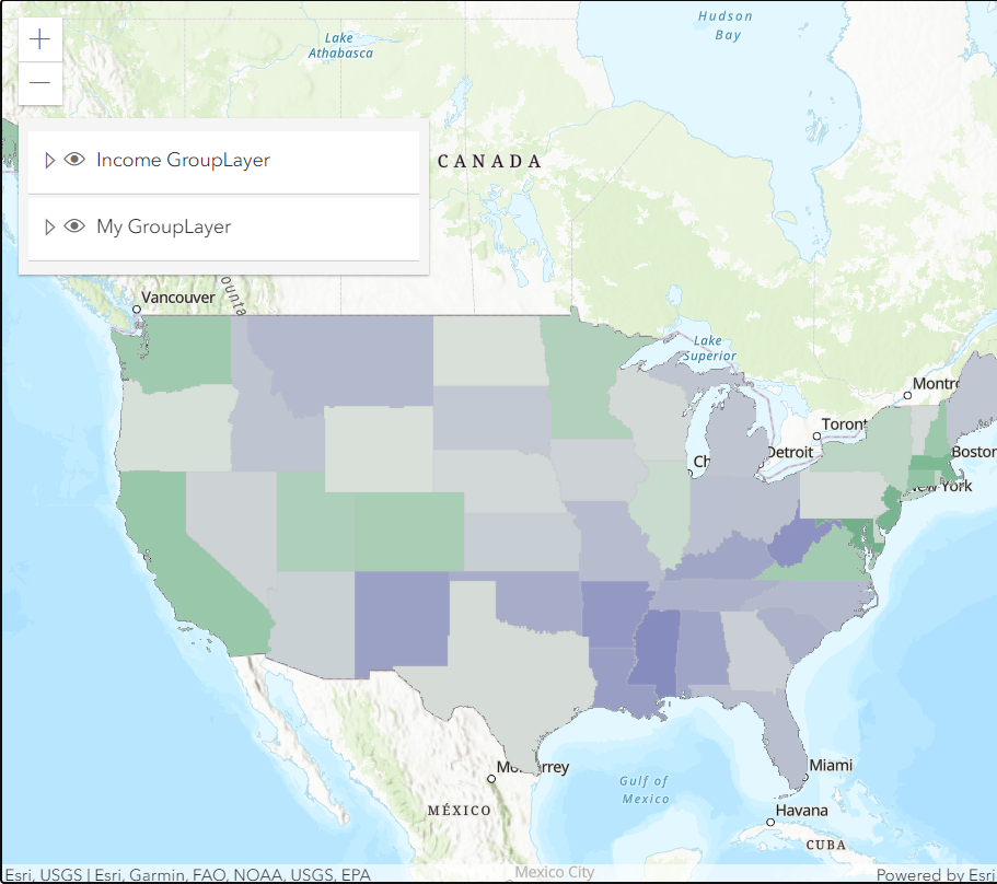

Hello, does anyone know how to hide an entire GroupLayer by default? Meaning that when the page loads, one of the GroupLayers are hidden (eye icon crossed out) on the LayerList.
Here is what it looks like right now (on page load):
As you can see on the LayerList, both "eye" icons are not crossed out

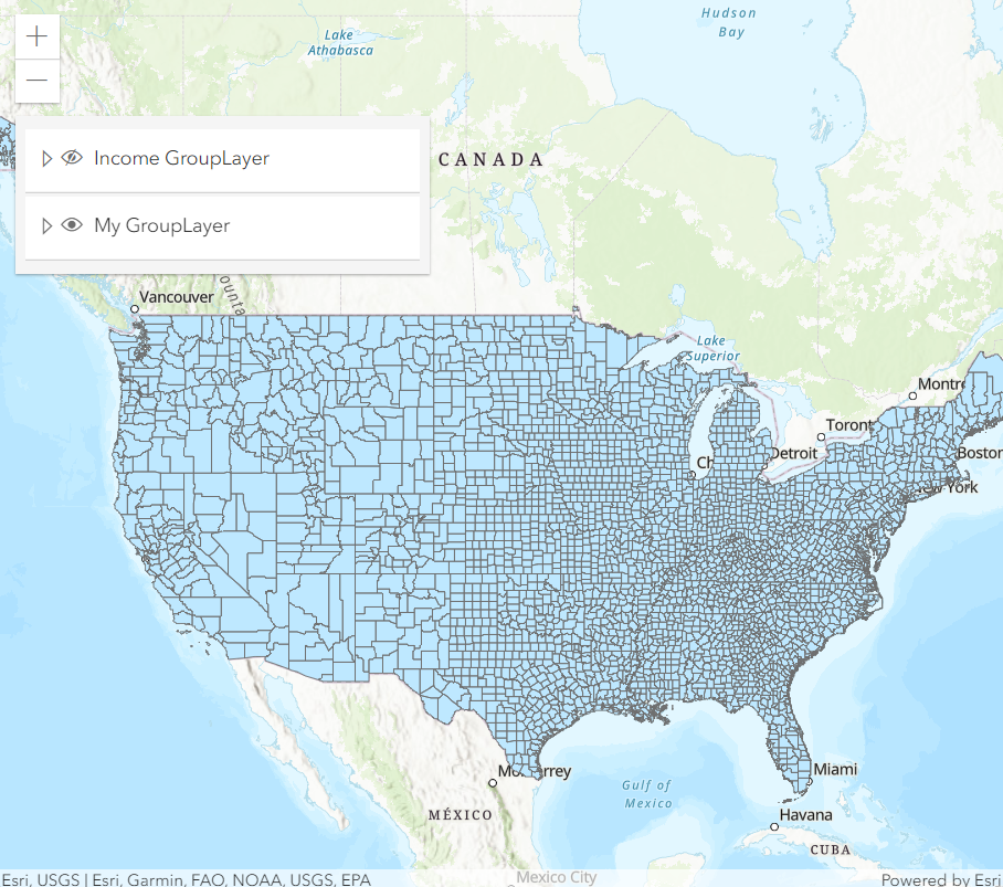

Here is what I am trying to achieve:
You can see that the first GroupLayer is toggled to be hidden. But I was only able to do this after the page loads, is there a way to code it so that the first GroupLayer would be toggled to be hidden by default? Thanks!

Set the GroupLayer's visibility to false when you construct it
var incomeGroupLayer = new GroupLayer({
  title: "Income GroupLayer",
  layers: [tractIncomeLayer, countyIncomeLayer, stateIncomeLayer],
  visible: false

klzheng
Thank you so much!
