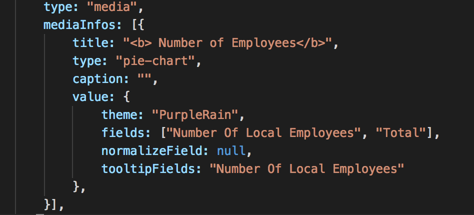

  type: "media",
            mediaInfos: [{
              title: "<b>Count by type</b>",
              type: "pie-chart",
              caption: "",
              value: {
                theme: "Grasshopper",
                fields: ["relationships/0/Point_Count_COMMON"],
                normalizeField: null,
                tooltipField: "relationships/0/COMMON"
specifically this line:
I understand that we need to pass the fields which according to them the pie-chart is getting charted, however when I pass my field "Number Of Local Employees" I get one full pie chart with one color, but that's granted I passed only one color, However in the posted code above, the example passes only one field as well and get multiple slices in the same pie chart.

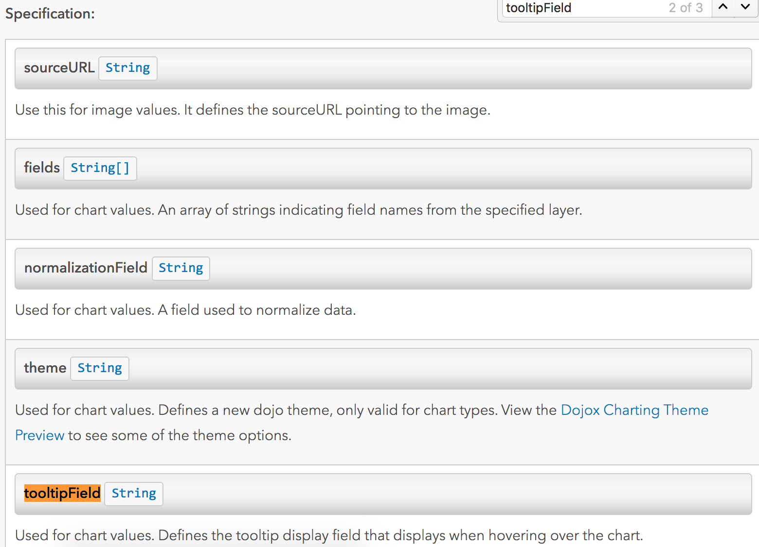

This is somewhat crucial because when I look at the documentation for the tooltipField
it says that it accepts only a string compared to the fields which accepts an array of strings, so in case I'm passing multiple fields I can only show one type of tooltip in relation to the entered field
**Regardless of that, I struggle to show any tooltip on hover.

Is "Number of Local Employees" the name of field?  Make sure you specify the field name, not the alias.  Also, please note that the above sample has many slices (even though only one field is specified) because it uses all the returned records for the specific feature accessed via the relationship which is available to the service.  If not using a relationship, then each value in the specified fields for that feature becomes a slice.

I managed to show my pie-chart, however the hover still missing, even though I'm passing only one field (I'm using the field name as you mentioned above) maybe it because the name of the field and the alias are the same?
Also, could you expand on this relationship concept? It seem's like showing multiple slices in a pie-chart is the way to go for me. How would I go about replicating the same result in my case ,when I'm working with JSON objects?
fields property accepts multiple fields, however the tooltipFields only accepts one.
Anton.
