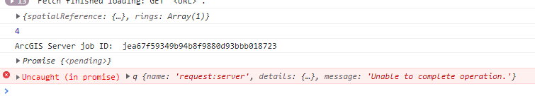

I've been trying to resolve this issue, but I can't find a real answer.
Most of the Clip-Zip-Ship scripts I found are for earlier  versions or links broken.
The rest of the codes I tried, but I'm missing something.
I'm making a custom widget based on Sketch widget within ExB / JS API to use GP submitJob for async GPService. After drawing a polygon on map, the event complete fires and should send the params to the GPService.
My problem is with the Area_Of_Interest parameter.
I don't know the format it expects. I tried so many and each one just throws an error.
One of them worked without errors, copied all the tables schema but no data. Its like I didn't send params.
GP Service Link
clip_zip_ship
If I use the SubmitJob through the service, it works even with minimal params. But if I take the code inside JS it's not working or gives me empty result. My guess is I'm formatting the JSON incorrectly through JS.

I also uploaded a zip with the files. What am I missing?
ReneRubalcava
Esri Frequent Contributor
Your GP service says the data type for Area_of_Interest is a GPFeatureRecordSetLayer
You can find more details on that data type on this page.
https://developers.arcgis.com/rest/services-reference/enterprise/gp-data-types.htm
There are various ways to define it. That page has various samples on how to define the input.

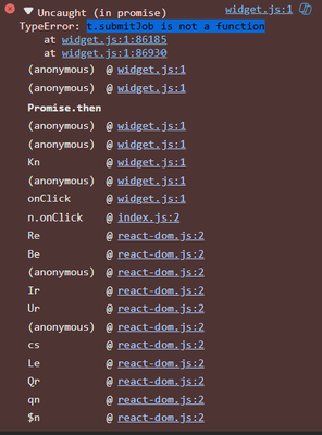

ENGEOGIS1
Hi there, thanks for sharing this. I'm also trying to deploy a custom widget with a button to trigger a GP service thats hosted on our enterprise server. I'm wondering whether you've encountered issue such that I'm able to run the GP service successfully with my local ArcGIS Experience Builder developer edition with no issue, but once I get the widget deployed, it's always getting stuck at the first step with an error message that says "t.submitJob() is not a function" .... have you met this issue? any insights on how to debug this? Thank you!
