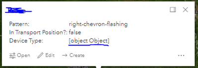

I am trying to make a GeoJSON Layer from a source I do not control. Everything works fine, but my one difficulty is that I have a property in the GeoJSON (example below) that is actually an Object, not a string/number, etc.
I am hoping to add fields from the 'core_details' property below into the GeoJSON layer, and into the popup template. Is this possible? Or does the GeoJSON need to be edited to split this object into individual properties? I am providing this layer a list of Fields to make this functionality work.

JoelBennett
MVP Regular Contributor
In this case, you may have to use a function to define your PopupTemplate content.  If you did, it might look something like this:
function getPopupContent(feature) {
	return "<table><tr><td>Pattern:</td><td>" + feature.graphic.attributes.pattern + "</td></tr>" +
		"<tr><td>In Transport Position?</td><td>" + feature.graphic.attributes.is_in_transport_position + "</td></tr>" +
		"<tr><td>Device Type:</td><td>" + feature.graphic.attributes.core_details.device_type + "</td></tr></table>";
var popupTemplate = new PopupTemplate({
	title: "My Title",
	content: getPopupContent
var layer = new GeoJSONLayer({
	url: myURL,
	popupTemplate: popupTemplate

UndralBatsukh
@JoelBennett is absolutely right. The code snippet he provided will work. I am adding perhaps the obvious point here. You need to set the fields in the GeoJSONLayer constructor and for the object properties you need to set the field type as blob and the code Joel will work. Here is a very simple test app that uses the geojson you provided and the code Joel provided.
https://codepen.io/U_B_U/pen/oNMozyJ?editors=0010
JulianDurantini
Thank you @UndralBatsukh and @JoelBennett so much! My issue was that I needed the 'type' property of my Field to be a blob. I'm glad you took the time to add the obvious!
