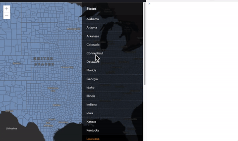

In this simple app, I am using FeatureLayerView.filter to only display counties of the selected state. Then I use the filter criteria to query the counties of that state. In the query, I set the query.orderByFields to county names. When the results are returned, they are ordered by the county names.

Check out this simple app.  The following screenshot shows how to use the app. Hopefully it is descriptive enough.
