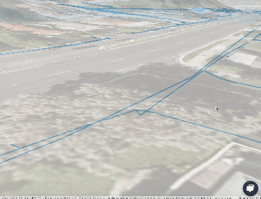

Hello, I have an issue with features 'flickering' in and out whilst moving the camera around in a 3D scene, when the layers have a FeatureFilter applied. The setup uses arcgis/core version 4.28.10, with a FeatureFilter being applied to OGCFeatureLayers and FeatureLayers in a WebScene.
Here's a clip of the issue;
I tried creating a mirror of the project setup with some test data in a codePen, and wasn't able to reproduce the same behaviour (maybe having more data in the layer makes the problem worse?). A similar flickering effect can happen when features overlap in 3D space (z-fighting), and when viewed from a particular angle (above or below), whether or not they have a filter on.
To test my theories I've tried the following in my project with no luck;
  • Included only one feature layer in the scene,
  • Turned off the renderers and various other view/layer config options
  • Using different Layer types (GeoJSON, OGCFeature)
  • Turning off base layers and ground layers
Any help on this would be much appreciated!

AndreasUlmer
Hmm, really hard to say what causes this without an actual reproduction case.
  • Could you still share the codepen (even if it doesn't reproduce the problem), so we have a starter what to look?
    (We specifically need to know what data and renderer / symbology is used, and how featureFilter is applied)
Also, can you check the following:
  • Can you check if it also happens with 4.29?
  • Can you confirm the flicker does not happen when FeatureFilter is not applied?
As said, hard to say but from the current recording I would say:
  • it's not z-fighting (happens only with coplanar faces)
  • FeatureLayer, GeoJSON, OGCFeature should not make a difference (the internal rendering is the same on those)
