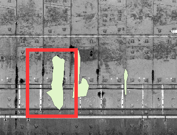

   When loading a Feature Service from my localhost, I came to this strange thing: All my feature layers are loaded without any error, but they can not be seen on the map.
   In ArcGIS, it should be like this:
   In Browser, it shows nothing. However, click on feature do does a query and returns the right data.
   Changing Layer's Display Order does not fix it.
   Do I have to write a client js Render myself, or am I missing something. Can anyone give some help.

Is your maps basemap and your layer in the same spatial reference? Are you applying the correct symbol for your geometry type? Your geometry is a polygon so are you providing a SimpleFillSymbol? It would help to share your code.
雯妍汤
  • My code is quite simple, just initialize the map and add layer to it by given some local server URL.
  • Layers' spatial reference are consistent, otherwise the popup won't show up at the right place when click on the feature.There is one thing I don't figure out, you said I should provide a SimpleFillSymbol, while I'm trying to use a Server Side Defined Symbol, is it necessary to write my own js code to implement this?
  • Inadvertently, I found some feature however can appear when panning the map left or right and disappear immediately if I pan again. Notice the rest of them marked as red lines are still invisible.

That sounds like what FC Basson was saying then, that the polygon is under the image.
Are you using the black and white image shown in the image above as a basemap or just another layer added to the map. Seeing your code I could determine most of the questions I will have to ask.
