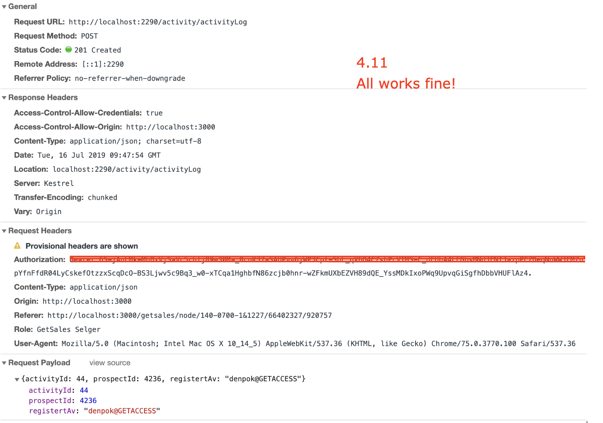

This code worked correct in 4.11, see image.
With 4.12 I get:

See image with Network log.JS API 4.11. Works correct!
JS API 4.12 Does not work!
Noah-Sager
It looks like the query is being assigned to a string instead of an object. I think you could try setting the body to a string, or pass an object to the query. Hope this helps!
