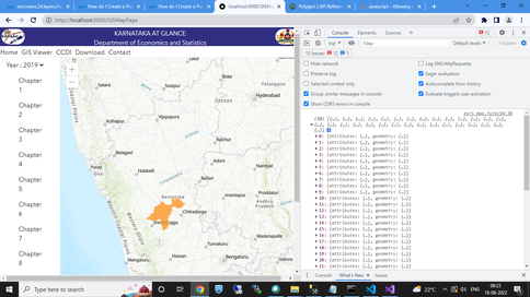

It is giving the error like this (firsttry.png enclosed)
  1. error: s
    1. details: {layer: l, error: s}
    2. message: "layerview creation failed"
    3. name: "layerview:create-error"

Can anybody guide where I am committing a mistake.  in feature layer creation or preparing data for feature layer creation.

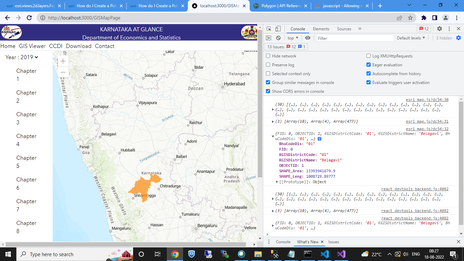

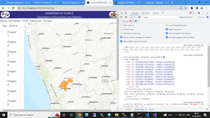

Hi this is the json file with one ring, after reading the file, if I console log the features, I am getting the bellow results, screen shot provided.
console.log(features);
console.log(features[0].geometry.rings);
console.log(features[0].attributes);

when I print the features in console, I will get the info like this
and single polygon ring like this
and single attributes like this
