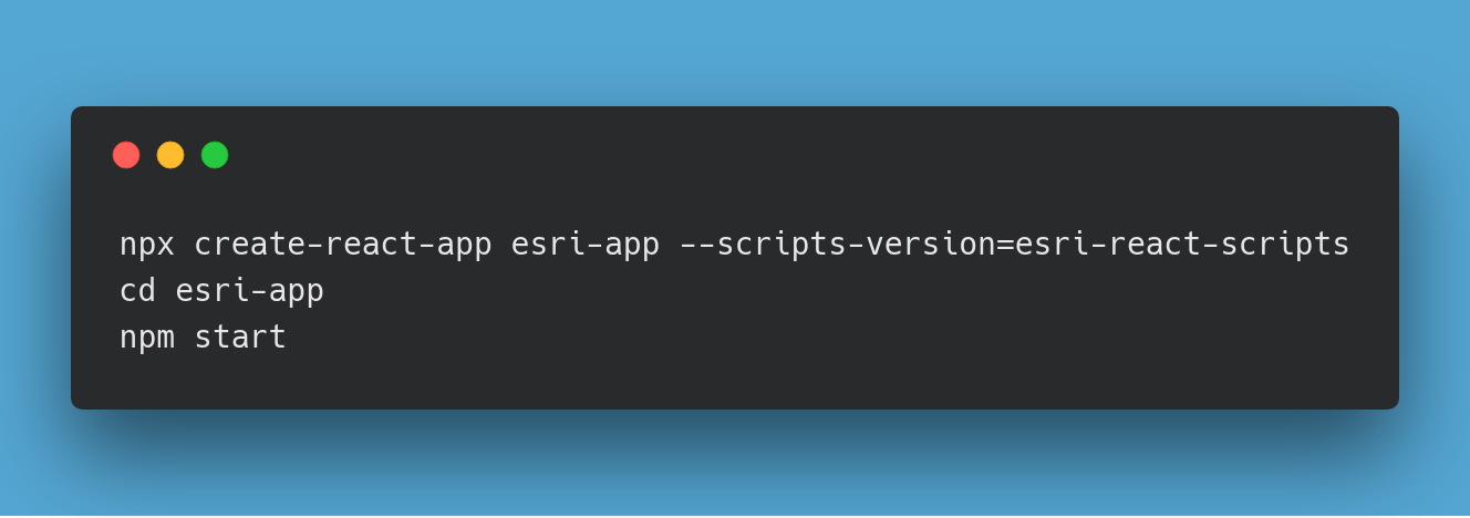

I just created a React boilerplate to create React application with the ArcGIS JS API. This template is using the famous Create-React-App tool. You can know forget about configure anything to make the ArcGIS API working with Webpack, Babel, Jest, etc ...
To start, you just need to have node.js installed and run the following lines of command:
npx create-react-app esri-app --scripts-version=esri-react-scripts
cd esri-app
npm start
You are now ready to create your React application without any configuration and lot of useful features !
