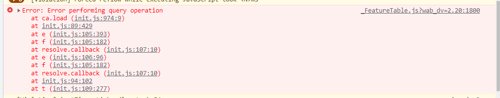

Console says this

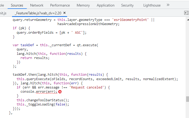

Sources Says this:

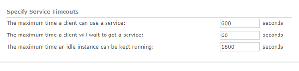

This is the Service that is having the issues.... Although the error is thrown at about 30 seconds.
I tested 600 seconds in the 2nd option below and no difference
