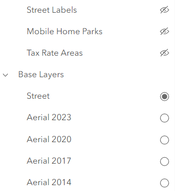

In my Esri map ReactJS TypeScript program, I have a LayerList widget, a portion of which I took a screenshot (Street Labels, Mobile Home Parks, and Tax Rate Areas belong to the reference layers GroupLayer; zero, one, or multiple reference layers can be enabled at the same time, but exactly one and only one base layer can be active at any given time):
I have a specific requirement that I need to fulfill (two specific behaviors; nothing more, nothing less):
At any given moment, if "Street Labels" is inactive and any Aerial (satellite imagery) base layer is clicked on (regardless of whether that Aerial layer is already selected), "Street Labels" is enabled.
At any given moment, if "Street Labels" is active and the Street base layer is clicked on (regardless of whether the Street layer is already selected), "Street Labels" is disabled.
