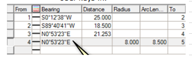

Hi @AndyGup , I am able to draw a line from a point based on given bearing (e.x. NE 0 deg 12 min 20 sec) and distance but couldn't find a way to draw a curved line from a point given bearing (e.x. NE 0 deg 12 min 20 sec), radius and arc length. Are you aware of how I can achieve it? Below is an example of how user will enter bearing, distance, radius and arclength values
AndyGup
Hi @mohammed_raufshaikh, I'm aware of the formulas to do it but haven't researched it recently, you might marked this post as answered and create a new post about curved lines to get better visibility from the community. Here's a simple example of how to draw a curved line between two points: https://community.esri.com/t5/arcgis-api-for-javascript-questions/how-to-draw-a-curved-line-between-...
