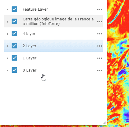

I'm working on making LayerList items to be draggable so that users would be able to reorder the layers by dragging them. I've found Shopify Draggable might be the closest approach. However, the application(open CodePen) loses some of its functionalities after the LayerList is dragged. It's a shame that v4.x doesn't support dragging natively like v3.x did. Is there any other way to perfectly reorder LayerList layers with dragging?

I had to do this and Victors sample is definitely missing functions (e.g. createItem) and things with the laterlist look like they have changed since.
I have wrapped up the code into blocks that can just be pasted into layerListview.
The css will give you the map viewer style dotted line.
Notes
  • Because wab doesn't nest the expanded items (the layer swatch) it only supports dragging above an item.
  • Feature layers can't be moved, this is a limitation of 3x.
  • there well may be edge layer types I haven't tested.
  • tested and working with 2.20

DavidWilton
I decided it would be better to separate the code from the esri code. To install rename the LayerListView.js to LayerListView_esri.js and copy over the files.
This version also adds a drag handle styled as per the map viewer
