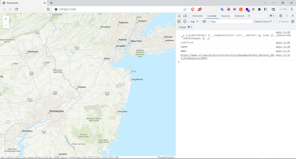

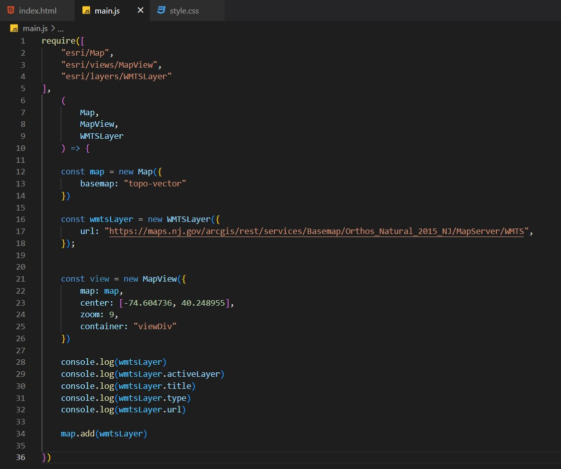

Hello everyone.
I'm using the ArcGIS Maps SDK for JavaScript, and I want to create a map and consume a WMTS layer. According to the documentation, it says to use the WMTSLayer class. However, the service is not displaying on my basemap.
The link to the WMTS service I want to read is: https://maps.nj.gov/arcgis/rest/services/Basemap/Orthos_Natural_2015_NJ/MapServer/WMTS
I am attaching the code I am using, and there are no errors in the browser's inspector console.
I appreciate any help you can provide
JoelBennett
MVP Regular Contributor
When using tiled layers, your map's layers should all use the same coordinate system.  Therefore, in this case, you should use their Web Mercator-based service instead:
https://maps.nj.gov/arcgis/rest/services/Basemap/Orthos_Natural_2015_NJ_WM/MapServer/WMTS
Also, since this is an ArcGIS Server map service, there's probably not much value in using the WMTS interface.  You could use a TileLayer instead, with the URL:
