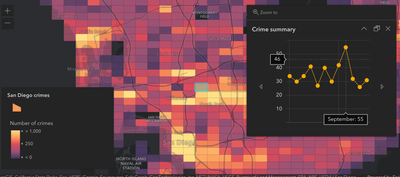

Suppose we have a Date field in our initial layer. Is it possible to have a histogram displayed when we click on a rectangle, showing the monthly evolution?

Yes. This is possible. You need to query the features within the bin and create a column chart representing however you partition the data. This sample demonstrates how to query features inside a bin using Arcade: https://developers.arcgis.com/javascript/latest/sample-code/featurereduction-binning-arcade-summary/
In the popup, click one of the arrows next to the pie chart to see a similar visualization using a line chart. This chart displays the number of crimes that occurred in each month within the bin.
