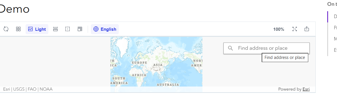

Hi,
there is a tooltip on the input which simply shows the previous placeholder/watermark.
Its gone, after typing any input.
I would like to disable this tooltip at all.
In case the locator is enabled as single source its gone and replaced by a locator message.
This shouldn't be disabled.
Seen on the sample here:
https://developers.arcgis.com/javascript/latest/references/map-components/components/arcgis-search/

its placed within an autocomplete, not an input.
<calcite-autocomplete autocomplete="off" class="autocomplete" overlay-positioning="fixed" title="Alle" alignment="start" placement="bottom-start" scale="m" status="idle" icon="search" max-length="128" name="" calcite-hydrated="">
Placing the following code into any one time method, removes the tooltip once.
On any change of the source I need to watch on that an re-run this code.
Kinda hacky, hoped for a more build-in solution.
<arcgis-search #search ... />
private readonly _searchRef = viewChild.required<ElementRef<HTMLArcgisSearchElement>>('search');
const searchElement = this._searchRef().nativeElement;
searchElement.addEventListener('arcgisReady', () => {
	// Das calcite-autocomplete Element im ersten Shadow DOM finden
	const autocomplete = searchElement.shadowRoot?.querySelector('calcite-autocomplete');
	autocomplete?.removeAttribute('title');
I tried the arcgisPropertyChange but this is not fired when changing the active search source via dropdown.
(arcgisPropertyChange)="searchPropertyChange($event)"
    searchPropertyChange(event: CustomEvent<{ name: String }>) {
        if (event?.detail?.name === 'active-source') {
            const autocomplete = this._searchRef().nativeElement.shadowRoot?.querySelector('calcite-autocomplete');
The breakpoint on the if is never hit.
Just noticed, that there is no attribute-name for searchSource like search-source. May that is an indicator that this property is not part of the event at all?

Great, thanks @SebastianKrings. I meant for any arcgis component, not just search, but we'll start with search and re-examine our tooltips story.
