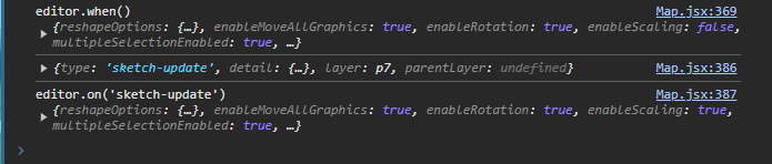

achyl
It didn't work,
I set this property in editor.when(), but when I create a new object, this property is overwritten
