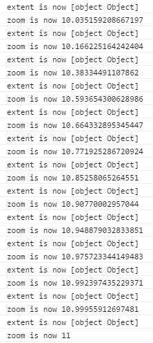

I'm trying to detect when a map has been zoomed in or out, and when that is complete to execute a function. I have tried using watchUtils.watch on both the view.zoom and view.extent properties, but am finding that the callbacks get executed too many times.
Here's the TypeScript code I'm using, where the console.log statements are getting executed too many times:

Here's what the output looks like in the console:
Is there a way to detect the change only when the zoom is complete? Perhaps there's another approach for accomplishing this than watching these properties?

Thanks for the suggestion, I've given that a quick try but it doesn't seem to be working reliably. The updating status seems to be changing multiple times throughout the zooming process.
