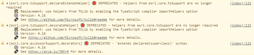

I'm creating a custom widget with ArcGIS JS 4.16 using this example:
Custom Recenter Widget | ArcGIS API for JavaScript 4.16
EDIT:
I get these warning messages in DevTools when I run the map containing the widget.
When I click on .(index):115 the ArcGis JS 4.16 index file appears, so I think that it's not my code causing these messages, but is actually a bug in the API. Can anyone confirm this?

Can you run a search on your files where you are using tsSupport and paste the code?
I've also used the demo widgets (as suggested in the tutorial) and don't recall any usage of that class name in the files.

Thanks, Shay. I think the ArcGIS JS API is the problem. I've edited my question to suit this new idea.

These warnings don't show up in the live sample, can you please post a repro app. I copied the tutorial you linked locally as well and don't see these warnings.

Just found that I had another custom widget causing these warnings. Once I'd upgraded that to use the helpers from TSLib, the warnings disappeared. So, you're right the example code is correct and works fine.
