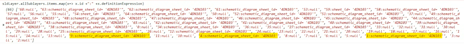

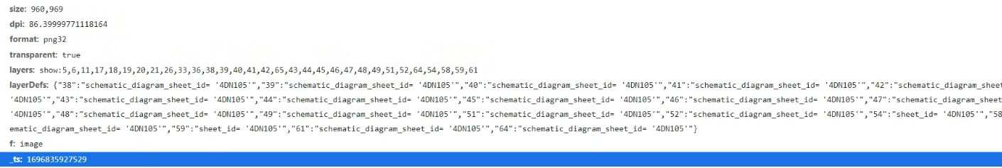

I have loop through and I have applied defnitionExpression for each sub & group layers which has attribute fields, When I see the request data from developer tools, the definition query is applied only to the Sub layer 11 to 23(Layer Indexes 38 onwards), but where as Group layer 1,2 & 3 does not have definitionExpression, it seems it is not applying on layers which has sub layers, please see the request data below, it starts from layer index 38, but layer Indexes 1,4 & 9 are not there even though I have applied definitionExpression.
Request data from Dev Tools,
Please find below screenshot that we have applied definitionExpression for group layers.
All the requests on MapServer/export does not have definitionExpression for Group layer 1,4 & 9, hence the features were not filtered from map, where if I append to the get request manually and sent request to server in a separate browser window, I could able get proper response.
