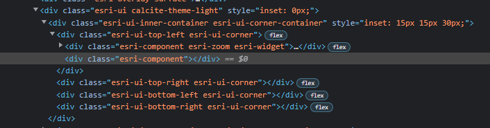

There is a DIV element added to the DOM - likely a wrapper for the widget - but not the content of the widget:

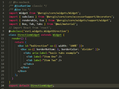

jefferson_bzp
@AndyGup ,
First of all, thanks for the above answer, it helped me to solve this issue.
As I said, the above solution worked when I use the native html markup, however, when I add Material UI for example, the error below occurs.
Source code
Is there a workaround?
