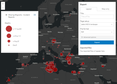

@Wade  By default Print widget in JS API honors only the visible layers.  I tested the sample and it is working fine. please check the screenshots Sandbox app with displaying he legends:
 and the print generated from the app:
 If you can provide more details on the requirements we can check.
