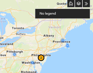

Hi,
I am trying to extend FeatureLayer in order to add minor, but important to me, functions and properties.
When I do create and instance of the FeatureLayer sublayer, I can see no legend, where I do see a legend when I use the generic FeatureLayer.
Even this example of a Sublayer for Feature layer does not show any symbols in the legend:
@subclass("myproj.classes.layers.CustomFeatureLayer")
export class CustomFeatureLayer extends FeatureLayer {
       //Purposely left empty to test legend
What should I do to make a subclass of a FeatureLayer recognizable by the legend?
Is there a function I can override in the Legend?
Is there something I can add in the ActiveLayerInfo object to make the Legend pay attention?

The Legend determines internally what layers it supports and doesn't via the layer's declaredClass property.  If it isn't a recognized type (e.g. "myproj.classes.layers.CustomFeatureLayer"), then the layer won't be supported.
If you don't have any custom logic driven by the declaredClass property, and none of your added properties or methods contain anything terribly conflicting with the default implementation, you can just reset it (preferably with your constructor);
this.declaredClass = "esri.layers.FeatureLayer";

Thanks Joel,
That worked!
