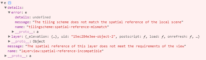

I`ve a question regarding using Custom Elevation Layers with exaggeration in local scenes. I`m generally following the following Esri example:
Custom ElevationLayer - Exaggerating elevation | ArcGIS API for JavaScript 4.4
I`ve a working scene with an elevation layer and the elevation layer and scene seems to work fine.
Check out the code on Plunker
If I try to replace the not exaggerated elevation layer 'elevLayer' with the exaggerated one 'secondElevLyr', then I get an error:
I`m not totally sure if our elevation service is already visible to the internet but maybe someone has a few hints for me how to check the tiling scheme mismatch?

4 Replies
ThomasSolow
Your elevation layer does seem to be private, but searching for that error in the source code tells me that it gets thrown when:
elevationLayer.tileInfo.spatialReference !== view.spatialReference
Looking at the BaseElevationLayer class, it seems that the spatial reference is always set to web mercator for the layer and for the tileInfo property.  I don't know why this is (I think it's just an assumption they made, that users are mainly going to create BaseElevationLayers to use the Esri world elevation layer, which is in web mercator), but you might try manually setting the SRs in the load function:

Now in Chrome Dev Tools beside some other errors I get another strange message. It tells me that the root scale leve of our tiling scheme which is 1:2.048.000 is to large for layers extent oO. Sure my SceneView is clipped but I expect the layer to choose the appropriate tile level !? Furthermore it suggests me an even bigger root scale of 1:600.000.000 which makes even less sense to me.
So is there something wrong with our tiling scheme? It`s our common tiling scheme and we use it for all services of our environmental agency. It`s the same like in the base layer which should be public and visible to you.
