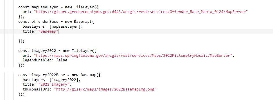

I have 10 years of aerial photography I need to add into a Basemap Gallery. "LocalBasemapsSource" will not work for me at all. Please help. These are examples of just 2 layers that need to be added into the Gallery.Screenshot 2024-03-11 154759.png

Try using MapImageLayer instead of TileLayer.
