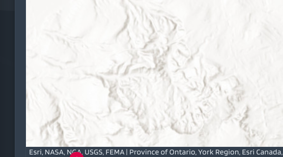

I'm trying to configure a CSP header, and every time I try to load one of the maps, it just doesn't render, this is what I get:
This is my CSP setting:

AndrewMurdoch1
Thanks for the suggestion.
The issue, I was missing: https://js.arcgis.com/4.26/@arcgis/core/assets/esri/core/workers/RemoteClient.js in script-src.  Once I added that the workers were able to load and everything, so far, has been working great.
Thanks
