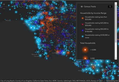

I think what you are asking could be accomplished, but as an alternative you might consider adding a Legend to the list item panel as shown in this sample. https://developers.arcgis.com/javascript/latest/sample-code/widgets-layerlist-legend/ this would enable to you have symbols that differ in more than just the color and still provide your users a preview of what the layer looks like on the map.

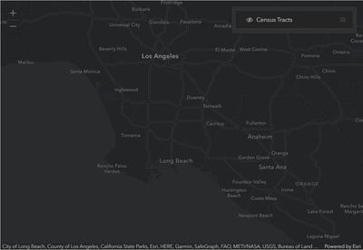

The Legend widget by itself doesn't have the ability to turn on or off the visibility of layers but when it's added into the layer list's list item with the listItemCreatedFunction the ability to toggle layers on and off in LayerList widget is preserved.  So you can still control visibility with the visibility icon (eye) on the left of the layer name and open and close the panel containing the legend with the right hamburger looking button.
Layer and legend visible
Layer and legend not visible
In your example you would end up with three layers in your layer list and each layer would have a legend that shows how that individual layer looks on the map right underneath it.

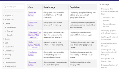

Hi.
I think I may have answered my own question. From the attached screenshot it appears at first sight that GraphicsLayer is the right choice
Sage_Wall
Happy to help,
Ahh, that explains some things. GraphicsLayer are great for quickly adding graphics to the map but it is generally preferred to construct a FeatureLayer with its source property when working with client-side graphics since the FeatureLayer has more capabilities than the GraphicsLayer, including rendering, querying, labeling and in your case better Legend support. This functionality is somewhat new and it looks like we need to update the table.
