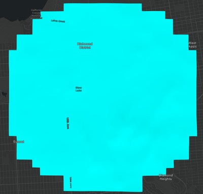

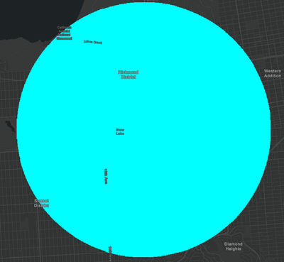

As the title says, the layer only shows a very low level-of-detail when in SceneView, even when zoomed in close.
MapView vs SceneView:
Can be replicated by changing MapView to SceneView in this sample:
https://developers.arcgis.com/javascript/latest/sample-code/sandbox/?sample=layers-imagerytilelayer-...
