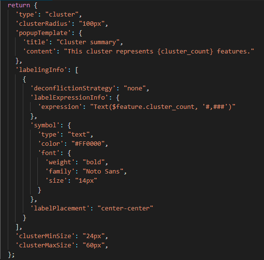

Hello Team,
Using ArcGIS API 4.19
In our project we have one parent group layer and inside that multiple group layer which have collection of feature layers created from client side features. For each individual feature layer we can turn ON/OFF cluster.
Example:
'Predefined' a parent group layer and added a child group layer 'Test' which have multiple feature layers like Test1, Test2, Test3, Test4.
Suppose we turn ON cluster for 'Test1' feature layer. Everything works as expected.
Now we added a new child group layer in Predeined group i.e. 'Custom' group layer which have multiple feature layers like custom1, custom2, custom3. When we turn ON cluster for 'custom1' layer, cluster is created, however it does not show labels on it. Same behavior for all 'Custom' group feature layers.
Question:-  Why cluster labels are not visible for 'Custom' group feature layers?
Is this something default behaviour or some settings are required
Cluster creation code:-cluster.PNG
