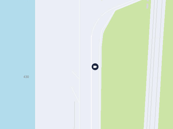

In 2D (mapView) my CIMSymbol is looking fine (with a custom font*)
*custom font and my esri config:
esriConfig.fontsUrl = './assets/font/';

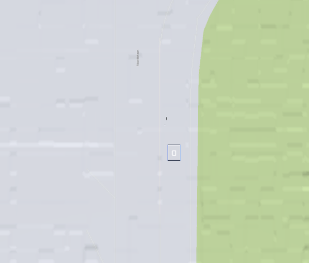

When switching to 3D the CIM symbol can't find the custom font? And it looks like:
Is this a known issue?

michaelpoa
You can reproduce the issue using this repo:
https://github.com/michaelkeesdev/arcgis-js
npm install + npm start
When chaning MapView to SceneView (app.component.ts) you will reproduce the issue
You should know about this,
@AnneFitz
michaelpoa
Maybe the answer?
  • The possible values for fontFamilyName property on CIMTextSymbol are dependent upon if you working with a MapView or SceneView. See the Labeling guide page for detailed explanation. Unsupported fonts will fall back to Arial Unicode MS Regular in MapView and sans-serif in SceneView.
AnneFitz
Hi @michaelpoa - the fonts are a bit different between MapView and SceneView. To bring in custom fonts in a 2D MapView, you would use the esriConfig.fontsUrl property, but in a 3D SceneView, you would use  CSS @font-face instead, and bring in the font data from web font (woff or ttf). Check out the labeling guide page for more information.
With that being said, I think there is a bug with our CIMSymbol implementation in 3D with icon fonts. We are investigating it further and hope to have a fix in an upcoming release. Thanks!
AnneFitz
We have a fix for this issue in the upcoming (4.27) release. You can test it out on our development /next version of the API.
Here's an example using FontAwesome in a CIMSymbol in a SceneView:  https://codepen.io/annefitz/pen/eYPpxpj?editors=1000 Notice how the font is defined within the CSS @font-face , then is used within the CIMSymbol.
