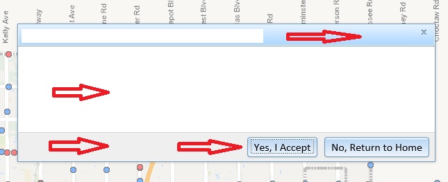

Good morning.  I have added a splash window to my application as shown below.
I am looking to change the colors of the title banner, main text space, bottom banner, button color, and dialog border (see red arrows).  I am using the DIV ID's and trying to specify the properties in .css, but I am not getting what I need.
Here is a sample of my HTML code:
    <!-- Application Splash Screen -->
<div data-dojo-type="dijit/Dialog" data-dojo-id="dialogWelcome" id="dialogWelcomeTitle" title="City of Edmond, Oklahoma - Survey Monuments" style="width: 600px;">
        <table class="dijitDialogPaneContentArea">
            <tr>
                <td>
                    <div id="splashScreenDialogMessage">
                    This is where the main test goes.
                   <br>
                   </div>
                </td>
            </tr>
        </table>
        <div class="dijitDialogPaneActionBar">
      <div dojotype="dijit.form.Button" id="buttonClose" data-dojo-type="dijit/form/Button" type="button" style="align-content: center" onclick="dialogWelcome.onCancel();">Yes, I Accept</div>
   <div dojotype="dijit.form.Button" id="buttonExit" data-dojo-type="dijit/form/Button" type="button" style="align-content: center">No, Return to Home</div>
        </div>
    </div>
I have looked at the dijit guide online for assistance, but have not found what I am looking for.  For those who have customized some splash screen windows, can you provide some guidance?  Thank you.

What does your css look for that element?
IanPeebles
It looks like this.  Properties are specified on index line number 177.
SteveCole
Honored Contributor
I would think that
background-image: none;
or
background-image: none !important;
should do it. That should eliminate the CSS gradients that are there by default (or not display the gradient PNG image).
IanPeebles
Steve,
That did the trick:
I have a solid blue title bar.  Going to change the text to white.  Thank you much!
